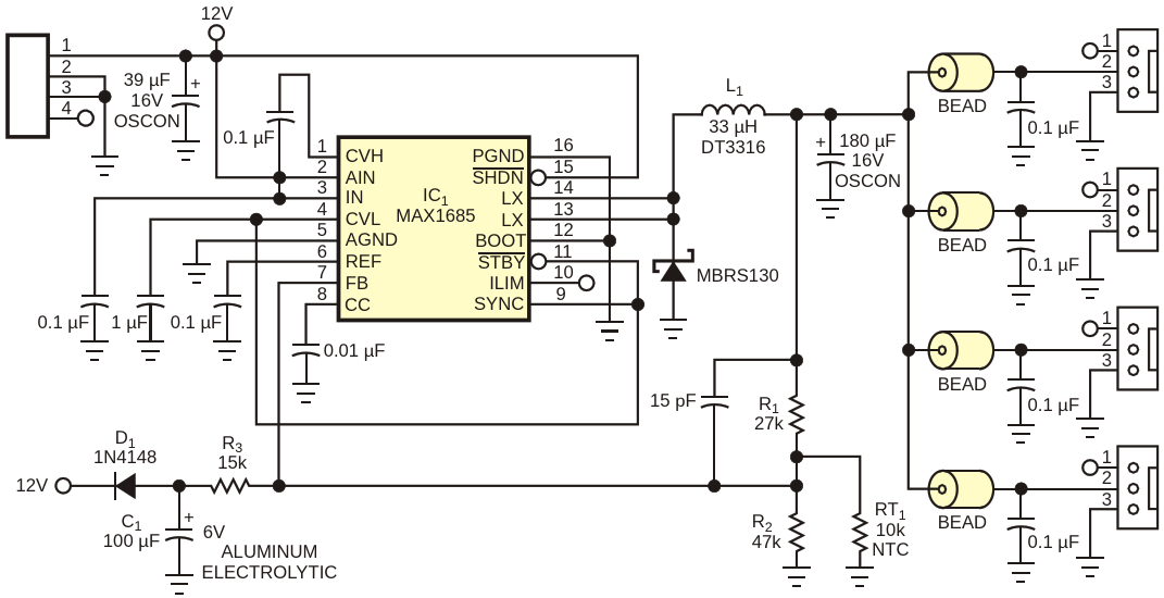

To control fan speed, …
To control fan speed, thermistor RT

adjusts the output voltage of this dc/dc converter

Circuit provides efficient fan-speed control
Figure 1. To control fan speed, thermistor RT
1
