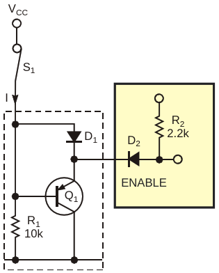

An active pulldown circuit …
An active pulldown circuit substitutes a saturated transistor for a power-consuming pulldown resistor

Active pullup/pulldown network saves watts
Figure 1. A conventional network requires a low-value pulldown resistor
Figure 2. An active pulldown circuit substitutes a saturated transistor for a power-consuming pulldown resistor
Figure 3. Rearranging the circuit and using an NPN transistor for Q
1
yields an active-pullup network
