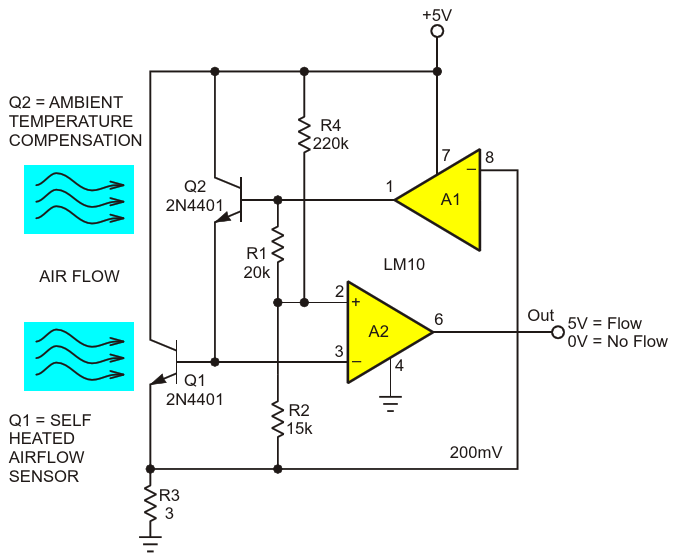

The flowrate sensor circuit
Stephen Woodward
Self-heated Darlington transistor pair comprises new air flow sensor
Figure 2
18 Kb
Figure 1. TO-92 junction temperature rise versus air speed
Figure 2. The flowrate sensor circuit
