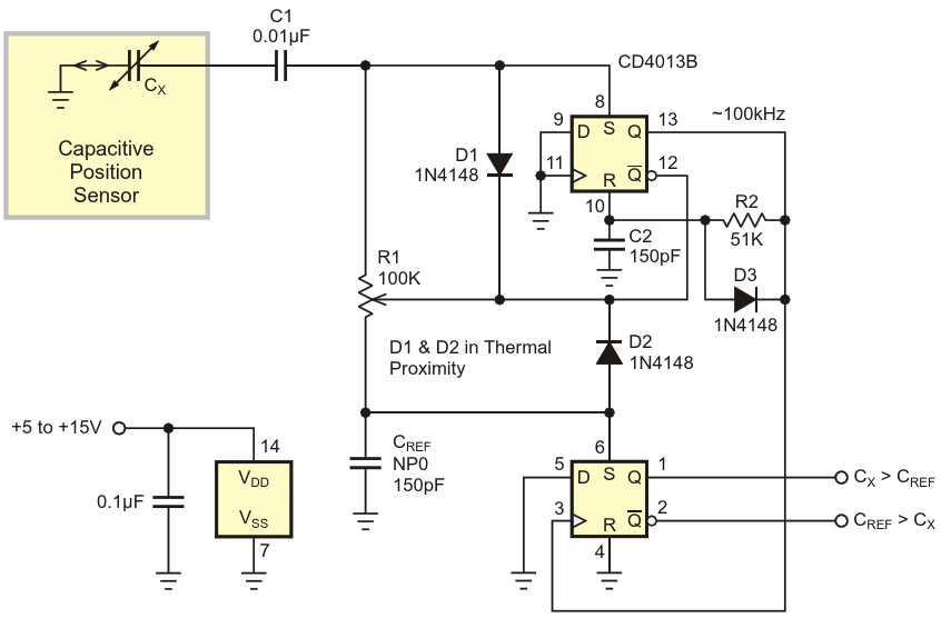

Motion limit/position sensing proximity switch using the CD4013B
Stephen Woodward
CMOS flip-flop used "off label" implements precision capacitance sensor
Figure 2
26 Kb
Figure 1. Circuit diagram with the CD4013B used as a capacitive humidity sensor
Figure 2. Motion limit/position sensing proximity switch using the CD4013B
