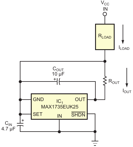

As in Figure 1, this low-side constant-current source draws a load current of 2.5 V divided by the output resistance through the load resistance, provided that you select the output resistance to make the voltage difference between IC1's input

As in Figure 1, this low-side constant-current source draws a load current of 2.5 V divided by the output resistance through the load resistance, provided that you select the output resistance to make the voltage difference between IC sub 1 /sub 's input
