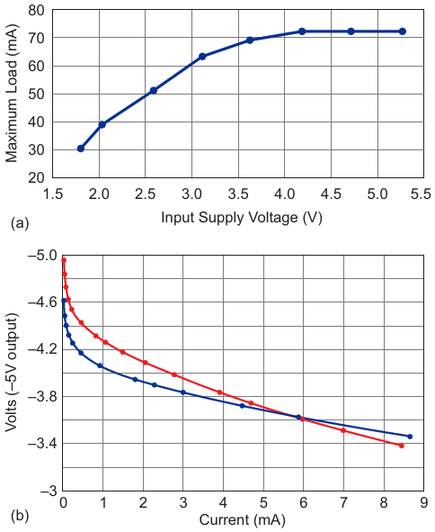

With auxiliary rails unloaded, the 5 V output's maximum available load current rises with input supply voltage (a). The auxiliary-output voltage levels depend on the load current (b)

With auxiliary rails unloaded, the 5 V output's maximum available load current rises with input supply voltage (a) The auxiliary-output voltage levels depend on the load current (b)
