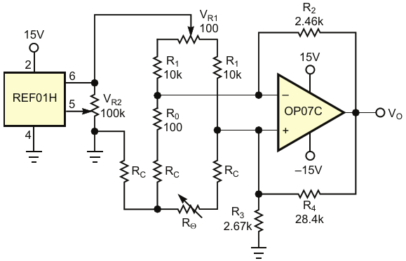

The full circuit needs trimming potentiometers VR1 and VR2 to adjust zero and span, respectively, and a three-lead cable for sensor connection. RC is the cable's resistance
