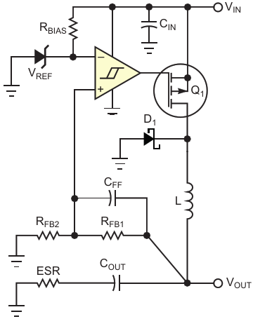

This hysteretic regulator suffers …
This hysteretic regulator suffers from unpredictability of the switching frequency because of C
OUT
ESR variance

Hysteretic regulators provide high performance at low cost
Figure 1
11 Kb
Figure 1. This hysteretic regulator suffers from unpredictability of the switching frequency because of C
OUT
ESR variance
