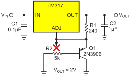

Adjustable regulator trimmer simple failsafe circuit
Figure 3
13 Kb
Figure 1. The typical regulator datasheet adjustment circuit
Figure 2. A simple failsafe circuit where the NC pin of the pot R2 (in Figure 1) is instead connected to Q1
Figure 3. Failure is an option!
Figure 4. Failsafe circuits with a negative regulator need an NPN Q1
Figure 5. Failsafe circuit with the pot wiper grounded
