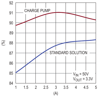

LTC3890/LTC3891 efficiency improvement
Goran Perica, Victor Khasiev
Bootstrap biasing of high input voltage step-down controller increases converter efficiency
Figure 4
9 Kb
Figure 1. Block diagram showing external bias
Figure 2. Voltage doubler allows external bias from V
OUT
in the range of 2.5 V to 4.7 V
Figure 3. Boost controlled by astable multivibrator is used for V
OUT
lower than 2.5 V
Figure 4. LTC3890/LTC3891 efficiency improvement
