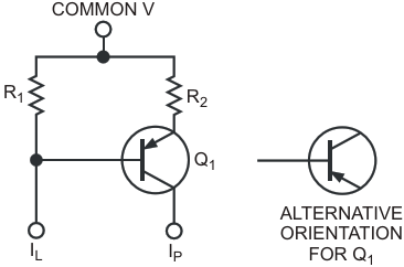

A laser-diode simulator requires …
A laser-diode simulator requires only one transistor
Nick Cornford
Laser simulator helps avoid destroyed diodes
Figure 2
9 Kb
Figure 1. A P-type-laser diode assembly includes the photodiode power sensor
Figure 2. A laser-diode simulator requires only one transistor
