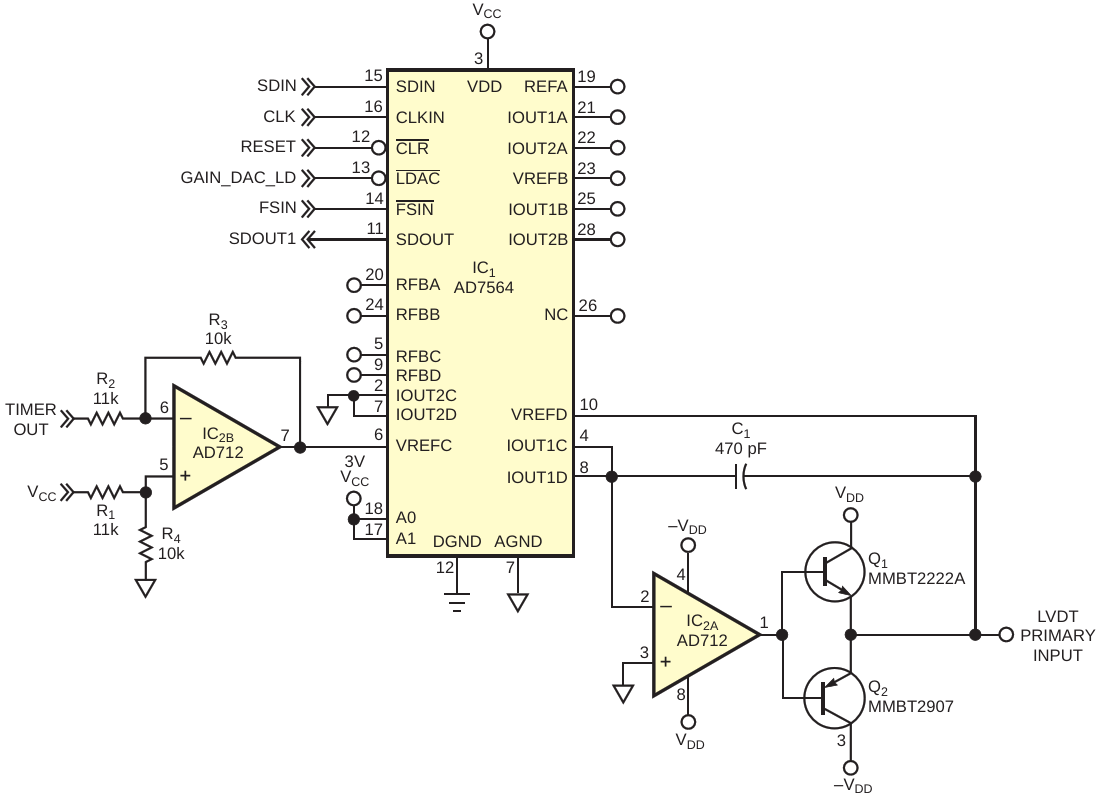

This circuit uses a triangular wave from a DAC to excite an LVDT

Figure 1. An LVDT is an electromechanical measuring device that converts the position of a magnetic core into electrical signals
Figure 2. This circuit uses a triangular wave from a DAC to excite an LVDT
Figure 3. Although what appears on the secondary side differs from the excitation signal, it is sufficient because of the inherent filtering properties of the LVDT
