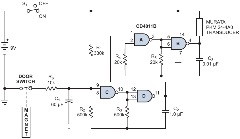

If the door and …
If the door and its switch are open, the low-frequency oscillator (C and D) pulses the transducer's 3-kHz driver ON and OFF
Fred Hicks
1-IC design monitors ajar doors
Figure 1
