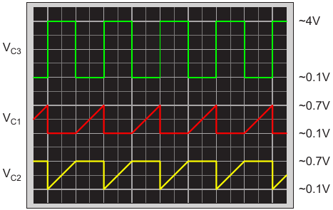

C1 provides oscillation-provoking positive …
C1 provides oscillation-provoking positive feedback by bypassing Q2, as revealed by Q1 and Q2 collector waveforms

Figure 1. It's a far better (temperature sensing) oscillator than an amplifier
Figure 2. C1 provides oscillation-provoking positive feedback by bypassing Q2, as revealed by Q1 and Q2 collector waveforms
