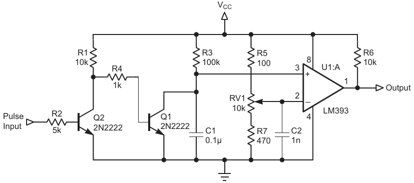

Circuit detects the long …
Circuit detects the long pulse whose width is decided by RV1's setting. The long pulse alone will be output while other short pulses are not. See text for RV1's potentiometer setting
Jayapal Ramalingam
A long pulse detector circuit
