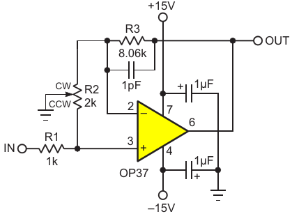

Low noise DC to 20 kHz audio gain stage based on the OP37 with pseudo-logarithmic gain adjustment

Adjust op-amp gain from -30 dB to +60 dB with one linear pot
Figure 1. Low noise DC to 20 kHz audio gain stage based on the OP37 with pseudo-logarithmic gain adjustment
Figure 2. Pseudo-logarithmic GIGO gain versus R2 wiper position 0 to 1 = fully CCW to fully CW
