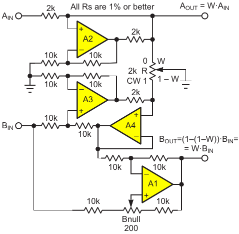

Op-amp solution requires four amplifiers comprising two Howland current pumps, a differential amplifier, and a boatload of precision resistors; it is also DC coupled
AuthorsStephen Woodward
Main DocumentArticle «Simultaneously control gain on two independent channels with a single element pot»
DescriptionFigure 1
File Format / SizePDF / 12 Kb
