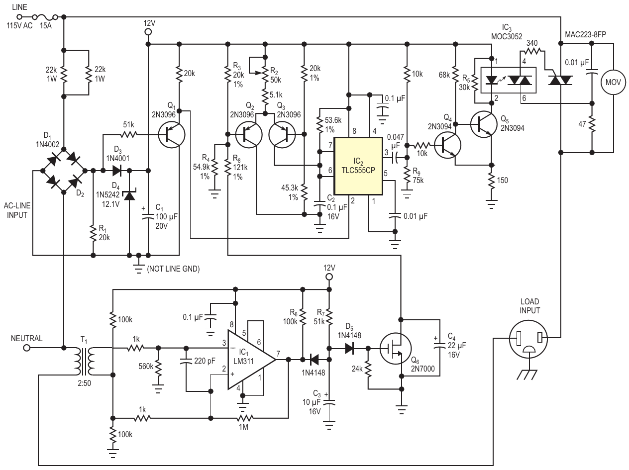

This soft-start circuit protects …
This soft-start circuit protects the load from large inrush currents

Soft-start controller is gentle on loads
Figure 1
30 Kb
Figure 1. This soft-start circuit protects the load from large inrush currents
Figure 2. The circuit in Figure 1 provides soft-starting by adjusting the phase angle of the power applied to the load
