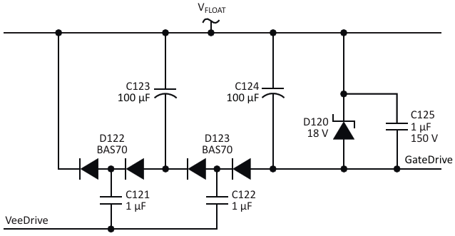

The charge pump generates a robust supply that always tracks 15 V below VFLOAT, even if that voltage is below ground. The voltage also can be placed above VFLOAT by simply reversing the diodes and the polarized capacitors

The charge pump generates a robust supply that always tracks 15 V below V sub FLOAT /sub , even if that voltage is below ground The voltage also can be placed above VF sub LOAT  /sub by simply reversing the diodes and the polarized capacitors
