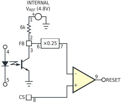

A typical current-mode architecture uses an optocoupler as a variable resistor
Christophe Basso
Bipolars provide safe latch-off against opto failures
Figure 1
11 Kb
Figure 1. A typical current-mode architecture uses an optocoupler as a variable resistor
