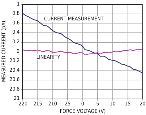

Over a ±20 V forcing-voltage span, the circuit produces an unloaded- output current-measurement error of -31 fA/V

Figure 4. Over a ±20 V forcing-voltage span, the circuit produces an unloaded- output current-measurement error of -31 fA/V
