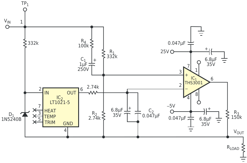

Virtual-zener circuit simplifies high-voltage interface
Figure 1. "Virtual-zener" circuits simplify the high-voltage interface in this position-sensing system
Figure 2. This virtual-zener circuit provides a regulated, "floating" voltage between the input and output
Figure 3. The transient response of the circuit in Figure 2 is exceedingly fast
