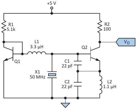

To avoid squegging in …
To avoid squegging in an RF oscillator, use this current-mirror biasing arrangement instead of the typical resistors employed for this role. The only critical components in this example overtone Colpitts oscillator are the matched transistors
Madhu Siddalingaiah
Use current-mirror biasing to avoid squegging in RF oscillators
