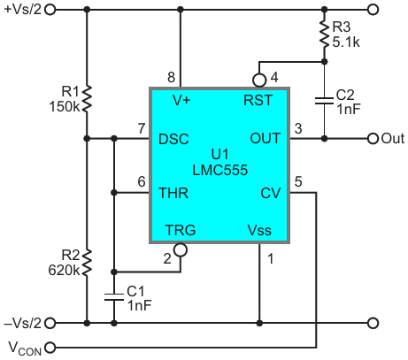

555 VCO discharges timing cap C1 completely to the negative rail via a Reset pulse

Can a free running LMC555 VCO discharge its timing cap to zero?
Figure 1. 555 VCO discharges timing cap C1 completely to the negative rail via a Reset pulse
Figure 2. The VCO waveforms; reset pulses at the end of each timing cycle, and is triggered when V

, to force an adequately complete discharge of C1
