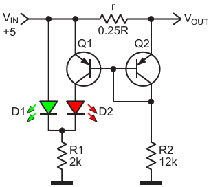

Current monitor circuit for …
Current monitor circuit for a wall power supply that is good for voltages from 3 to 9 V and currents exceeding 50 mA

Current monitor
Figure 1. Wall power supply indicator solution showing whether or not a current is being consumed by the load or not
Figure 2. Current monitor circuit for a wall power supply that is good for voltages from 3 to 9 V and currents exceeding 50 mA
