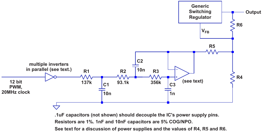

A microprocessor produces a …
A microprocessor produces a 12-bit, 20 MHz, PWM signal that controls a switching voltage regulator using an inverter IC, an op-amp, resistors, and capacitors to buffer the signal for the regulator's feedback pin
Christopher Paul
Another PWM controls a switching voltage regulator
Figure 1
