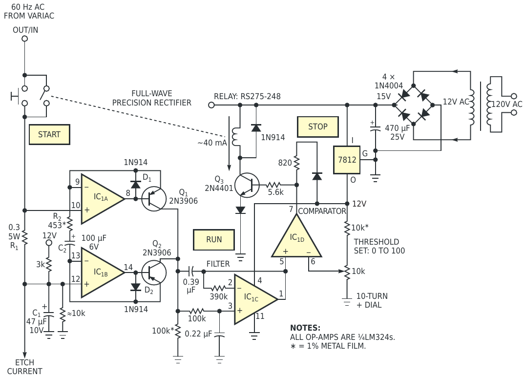

This etch-control circuit produces …
This etch-control circuit produces supersharp microneedles by terminating the etching process at precisely the right time
Stephen Woodward
Circuit controls microneedle etching
