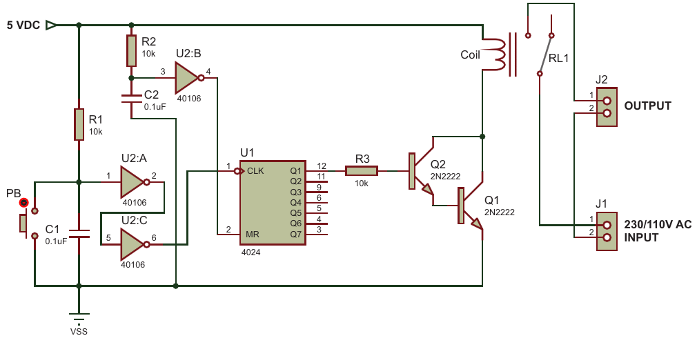

Pushbutton circuit that switches on ON and OFF for AC voltages using electromechanical relay (RL1)

Push ON, push OFF for AC voltages
Figure 1
19 Kb
Figure 1. Pushbutton circuit that switches on ON and OFF for AC voltages using electromechanical relay (RL1)
