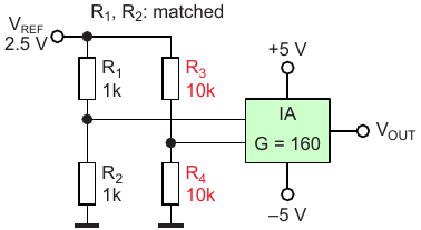

The intuitive solution is a circuit made of a Wheatstone bridge and an instrumentation amplifier

Figure 1. The intuitive solution is a circuit made of a Wheatstone bridge and an instrumentation amplifier
Figure 2. Circuit response is perfectly linear with a 1:1 ratio between output voltage and resistor mismatch
Figure 3. This circuit also provides a perfect 1:1 response, but at a lower cost
Figure 4. The transfer function provides a convenient one-to-one reading
