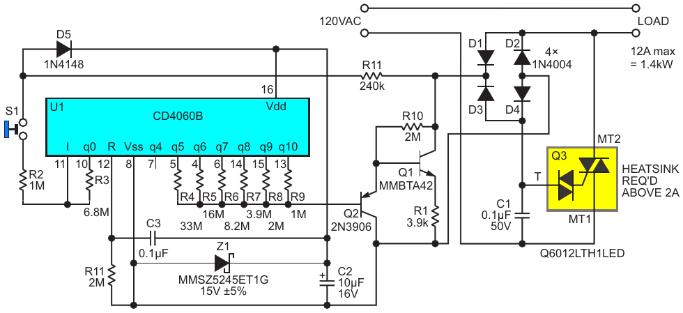

Variable AC power control with a simple pushbutton. When S1 is pushed, counter U1 ramps through the 64 DAC codes in a 2
10
/120Hz = 8.5-second cycle and stops on any selected power setting when S1 is released
Stephen Woodward
A different twist to the power pushbutton problem: A kilowatt AC DAC
