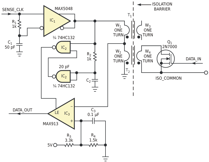

For each positive-going transition …
For each positive-going transition of SENSE_CLK, this circuit returns (at DATA_OUT) the state of the galvanically isolated digital signal at DATA_IN

Figure 1. For each positive-going transition of SENSE_CLK, this circuit returns (at DATA_OUT) the state of the galvanically isolated digital signal at DATA_IN
