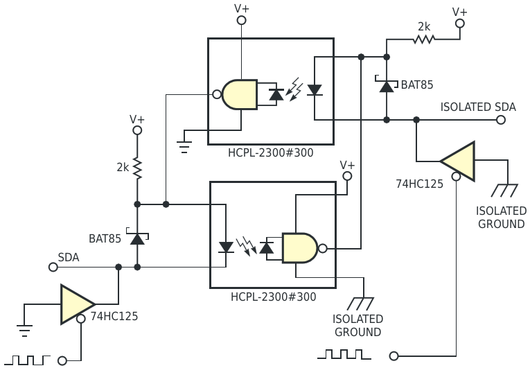

This circuit represents a …
This circuit represents a simple I
2
C isolator
Mark Thoren
Method provides fast, glitch-free isolation of I
2
C and SMBus signals
Figure 1
14 Kb
2
C and SMBus signals
Figure 1. This circuit represents a simple I
2
C isolator
Figure 4. The improved I
2
C isolator is fast and produces no glitches
