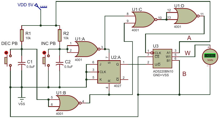

Each press of the …
Each press of the "INC" (increment) push button increases resistance by one step. Similarly, each "DEC" (decrement) push button press decreases resistance by one step. The power supply and ground pins of the various ICs are not shown i
Jayapal Ramalingam
Push to increase, decrease a digital potentiometer
