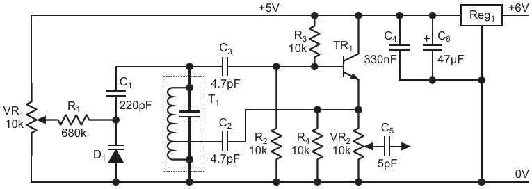

Add-on beat frequency oscillator (BFO) for shortwave radio
Figure 3
13 Kb
Figure 1. This sequence of images shows AM in the time (a) and frequency domains (b), along with SSB in the frequency domain (c)
Figure 2. These block diagrams show shortwave radios with BFO (a) and low-level BFO injection (b)
Figure 3. In this BFO schematic, VR
1
is the pitch and VR
2
is the level
