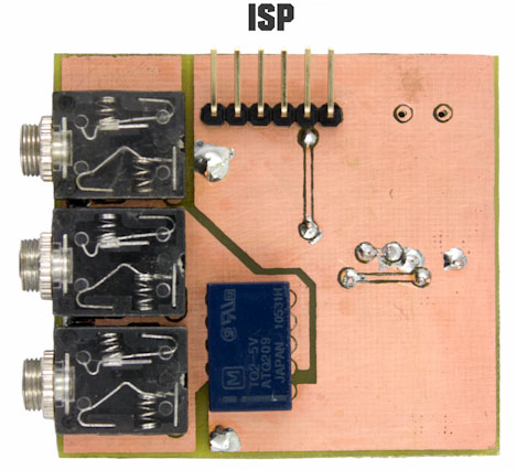

Design
As you can see, the “audio” ground completely isolated from “digital” ground. And I’m using top copper layer as a shield for both, audio and digital ground. This helps to isolate audio part from picking up noise from digital circuitry and other EMI.

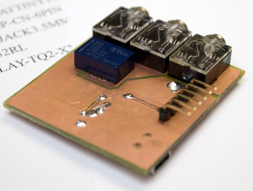

At first I wanted to make single-sided board, but eventually I’ve end up with double-sided one. Because of that the USB connector stayed on the bottom of the board and audio connectors on the top. But if you want you can easily change that fact.
USB Audio Multiplexer
USB Audio Multiplexer PCB
