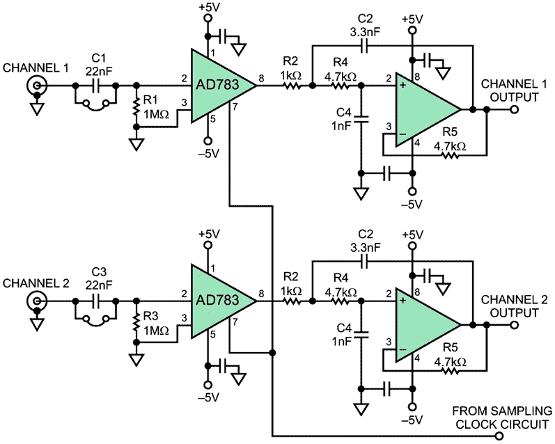

Figure 1 shows a schematic for a plug-in attachment that can be used for sampling with typical PC sound cards. It uses one AD783 high-speed sample-and-hold amplifier per oscilloscope channel. The sampling signal for the SHA is provided by the digital output of a clock-divider circuit; an example of one will be described. The AD783 input is buffered by a FET, so simple ac/dc input coupling can be used. In the two channels shown, 1-MΩ resistors (R1 and R3) provide dc bias when the dc-coupling jumper is open and the input is ac-coupled. The sampled output is low-pass filtered by the two-pole active RC networks shown. The filter need not be an active circuit, but the one shown usefully provides a buffered low impedance to drive the PC sound-card input.
Front End Turns PC Sound Card into High-Speed Sampling Oscilloscope
Figure 1. 2-channel analog sampling circuit.
The AD783 SHA provides a usable large-signal bandwidth up to a few megahertz. The effective slew rate at the input is above 100 V/µs. Input/output swing with a ±5-V supply is at least ±3 V. The small-signal 3-dB bandwidth for swings less than 500 mV p-p is close to 50 MHz.

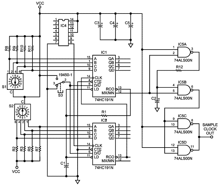

The AD783 requires a narrow positive sampling pulse with a width between 150 ns and 250 ns. The sampling pulse must be very stable with low jitter in order for the displayed waveform to be stable without jumping back and forth. This requirement tends to limit possible clock choices to crystal-based oscillators. Another requirement is that the sampling rate be adjustable or tunable over a range from slightly less than 100 kHz to about 500 kHz. The tuning steps between sampling frequencies need to be relatively fine for downsampled signals to fall somewhere within the 20 Hz to 20 kHz audio bandwidth of the sound card. A divide-by-N circuit, such as that shown in Figure 4, and a crystal oscillator with a frequency between 10 MHz and 20 MHz (IC4), can provide up to 200 or more different sample rates from 80 kHz to 350 kHz, with step sizes from 300 Hz to 5 kHz.
Figure 4. Sampling clock divider circuit.
In this example, using two 74HC191 4-bit binary up/down counters, N can be any integer between 4 and 256. Alternatively, decade counters, such as the 74HC190, with identical pinouts to the 74HC191, could be used to provide a range of N from 4 to 100. The division ratio is set using the two hex switches, S1 and S2. Switch S3 sets the counters to count up or count down. Resistor R1 (250 Ω) and capacitor C1 (68 pF) add a slight delay to the terminal count output before it asynchronously loads the start-count values. The four NAND gates of the 74HC00 are used to implement a one shot that makes a 200 ns sample pulse when R12 is 2.7 kΩ and C2 is 68 pF.

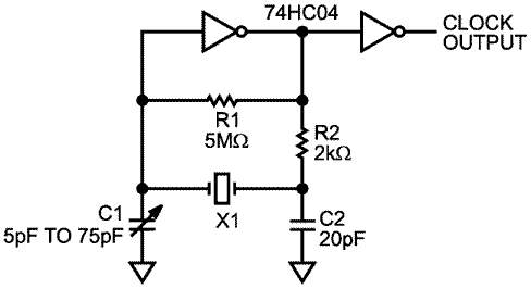

IC4 is a fixed-frequency metal-can crystal oscillator. Another approach would be to use CMOS inverters (74HC04) and a discrete crystal, X1, to form an oscillator, as shown in Figure 5. This approach, while using more components than the all-in-one metal-can oscillator, permits a small amount of frequency tuning by adjusting capacitor C1 to pull the crystal frequency.
Figure 5. Discrete crystal oscillator with mechanical tuning.

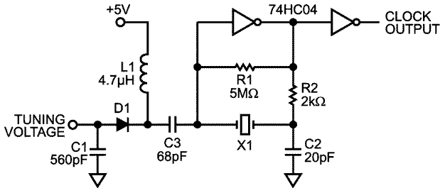

To avoid the mechanically variable component, use a varactor diode – which has voltage-dependent capacitance – for D1, as shown in Figure 6.
Figure 6. Discrete crystal oscillator with voltage tuning.
