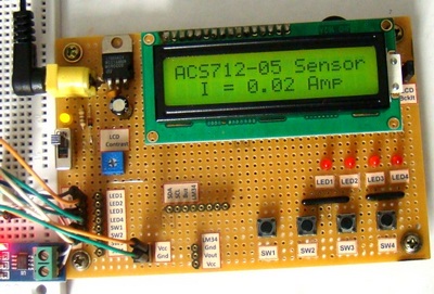

At zero input current, the ACS712 output should be ideally Vcc/2, which is equivalent to an ADC count of 512. A drift of 4.9 mV in the output voltage of ACS712 results in an offset of 1 LSB in the A/D conversion (for Vref = 5.0V, resolution of 10-bit ADC is 5V/1024 = 4.9 mV). Interestingly, one LSB is equivalent to 26mA of current for ACS712-05B. The drift of 4.9 mV or more in the zero current output voltage is considered likely to happen, which is reflected in the output shown on the LCD. I have seen the ACS712 output for zero input current fluctuating between 512 and 513 ADC counts. If it is 513, the displayed current would be 0.02 A. So it is always better to take multiple ADC measurements and then take their average.
Offset of 20 mA corresponding to 1 count
Offset of 20 mA corresponding to 1 count.

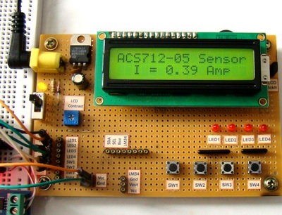

When the variable DC is set to 1.0 V, the current through the 2.7 Ω resistor should be 370 mA. The measured value is 390 mA, which is off by 1 LSB.
Output for variable DC input equal to 1.0V
Output for variable DC input equal to 1.0V.

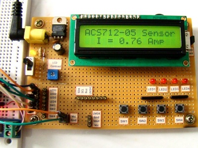

Output when DC inpt equal to 2.0 V
Output when DC inpt equal to 2.0 V.
