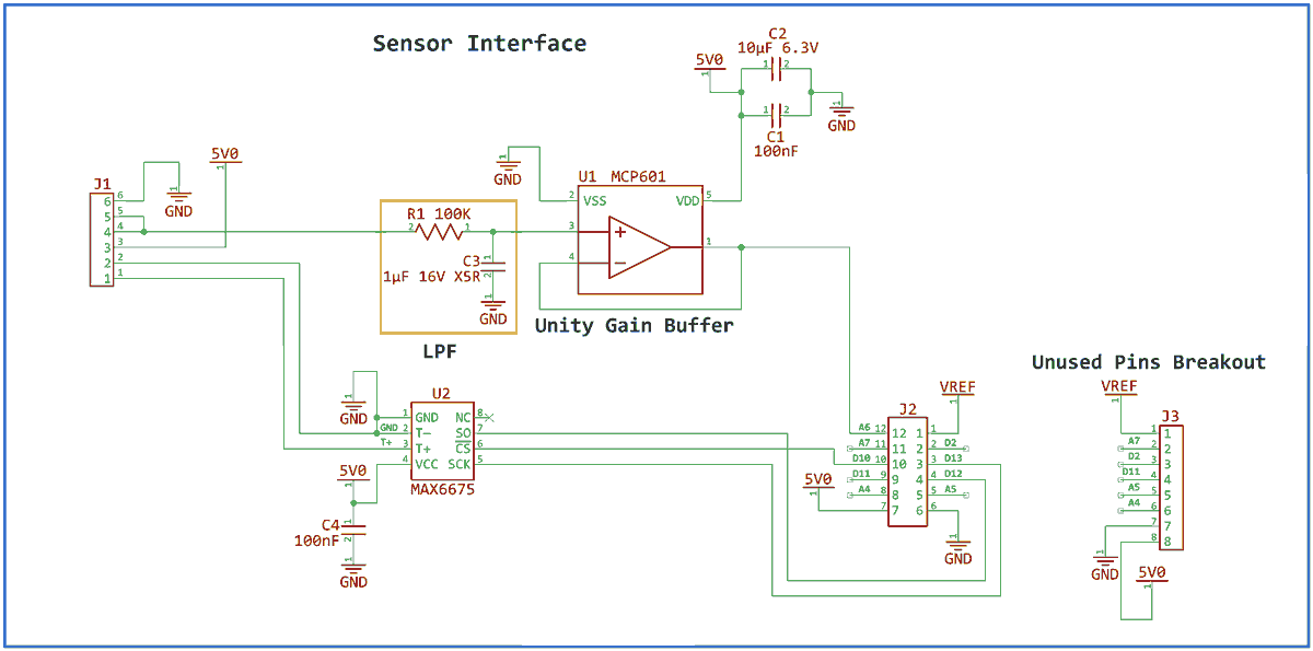

Basic Temperature Input Card
The basic temperature input card is able to read a thermistor sensor and a type K thermocouple sensor.
| Figure 7. | Basic Temperature Input Card. |
Features
- 1 thermistor input port:
- An external reference resistor is required to match the nominal value of the thermistor. The accuracy of the reference resistor used should be at least of that of the thermistor’s. (We chose to use an external rather than an internal reference resistor to give greater flexibility to the end user.)
- Can be used as generic voltage input sensor (example: potentiometer, LDR, etc)
- 1 type K thermocouple input port:
- Uses MAX31855KASA + MAX6675ISA+:
- Thermocouple open detection
- Cold junction temperature measurement available for use -200 °C to +1350 °C 0 °C to +1024 °C temperature measurement range
Depending on the application and desired accuracy, the user can select to use either the thermistor or the thermocouple as the input to the system. This can be selected in the PC-based user interface. You can even use them both by hacking the firmware to run two instances of PID module at the same time!
| Figure 8. | Basic Temperature Input Card Schematic Diagram |
