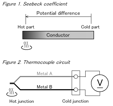

Seebeck effect
When apply a temperature gradient to a conductor like shown in Figure 1, a potential difference appears between hot part and the cold part. This is called Seebeck effect. The thermocouple is a temperature sensor based on this effect. This potential difference cannot be measured directly because it is canceled by the potential difference that also appears at the material of measurement circuit. However the degree of potential difference generated by the temperature gradient varies from type of materials, so that the difference of these potential differences can be detected by a combination of different type of metals that shown in Figure 2. The EMF by the Seebeck effect is called thermoelectric EMF. It increases with different of temperatures between the two junctions and well proportional to the temperature.
Seebeck effect,
There are some type of combination of materials (pure metal or alloy) as industry standard for temperature sensor. The K-type (chromel - alumel) thermocouple is the commonly used for generic industrial measurement. The output voltage of the K-type thermocouple is approximately 40 μV per degree C, so that a low input offset voltage amplifire is required at front end of the measurement circuit.

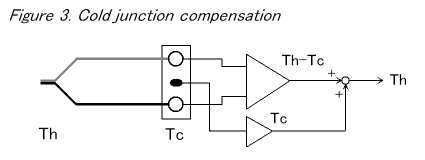

The thermoelectric EMF indicates the temperature difference between hot junction and the cold junction. This means the temperature at the cold junction must be known to calcurate the real temperature at the hot junction. This is done like shown in Figure 3, and it is called cold junction compensation. Note that the hot junction is the junction being measured and the cold junction is the input connections of the instrument. Hot junction is not that always hotter than cold junction.
