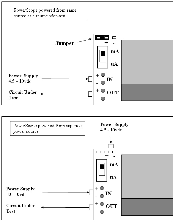

The PoweScope can be powered from the same supply as the circuit, or from a separate source, as shown below (Figure 4):
PoweScope can be powered from the same supply as the circuit, or from a separate source.
Figure 4. PoweScope can be powered from the same supply as the circuit, or from a separate source.

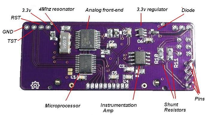

The PowerScope has a T.I MSP430G2402 microprocessor programmed in C using the Code Composer Studio. Program ROM is flashed using a T.I. LaunchPad, connected to a Windows PC via USB cable. A four-wire cable is used to connect the Launchpad to the four programming pads on the upper corner of the board (Figure 5).
PowerScope Component Placement.
Figure 5. PowerScope Component Placement.
Note the unused pads next to the processor chip. They are there to add a crystal for more precise time measurement if a user wants to program a display of cumulative mA-hours, for example.

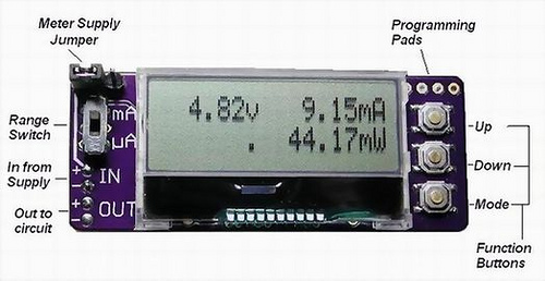

Calibration
Calibration is done in the software to avoid the need for tight-tolerance components.
Voltage and current measurements are calibrated and zeroed using the function buttons. A trusted multimeter can be used to calibrate volts and mA by connecting a power source to a resistor and measuring the current flow with both meters. Then, a high-value precision resistor can be used with a voltage source to calibrate the uA current range at values too small for the multimeter.
The mode button selects which value to zero/calibrate, then the up(+)/down(-) buttons will make adjustments. The measured value in the upper right will change in real time. The calibration constant used in the software is displayed on the lower right. The range switch position determines whether the mA or uA range is being calibrated (Figure 6). When you exit calibration mode, the calibration constants are saved in the “Info” section of the MSP430 flash ROM.
