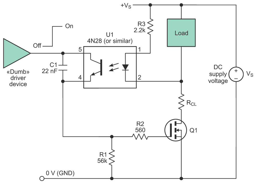

This simple circuit adds short-circuit load protection to a basic driver such as the output of a simple logic gate, while allowing it to control a high-power load operating at a much-higher voltage without fear of destructive short-circuit conditions.
This circuit builds on a previous idea in which the addition of an optocoupler to a microcontroller output converted a “dumb” high-side driver into a “smart” one with diagnostics and short-circuit protection. [1]
The circuit adapts this concept for cases where a microcontroller is either not required or inappropriate. It also adds short-circuit load protection to an even “dumber” driver such as the output of a simple logic gate (Fig. 1). As a result, it too allows a “dumb” low-level device to control a high-power load operating at a much higher voltage without fear of destructive short-circuit conditions.

Figure 1. The simple high-side driver can protect even a basic logic gate against load short circuits by controlling the optocoupler turn-on and turn-off periods.
Assume that C1 is initially uncharged, the driver output is at 0 V, and N-channel MOSFET Q1 is off. When the driver output transitions from a low level to a high level, the pulse couples through C1 and R2 to the gate of Q1, turning it on. Without the feedback provided via optocoupler U1, capacitor C1 would rapidly charge via R1, Q1’s gate voltage would fall to zero, and the MOSFET would turn off after about a millisecond. However, the presence of the optocoupler effectively allows the circuit to monitor the voltage across the load.
If the load is normal, the full supply voltage (+VS) appears across it when Q1 turns on, forward-biasing U1’s photodiode via R3. This turns on U1’s phototransistor, which shunts C1, pulling Q1’s gate up to the high-level drive voltage. Since C1 is now effectively “clamped” by U1’s phototransistor, it cannot charge up, so Q1 remains on and the load remains energized.
If the load is short-circuited at any time by a fault, though, U1’s phototransistor turns off, C1 rapidly charges via R1, and Q1’s gate voltage quickly falls to zero. The MOSFET now turns off, disrupting current flow to the faulty load, and remains off until the driver output is cycled low (to allow C1 to discharge) and then high again. The circuit will continue to “reset” to the off condition until the load fault is removed.
Resistor R2 provides current limiting to prevent Q1’s gate-source capacitance damaging the driver’s output at turn-on. It may also be necessary to prevent the MOSFET from oscillating. A value of a few hundred ohms is usually suitable.

In the case of the faulty load, the C1/R1 time constant largely determines the duration of the brief “on” pulse. If this time constant is too short, the optocoupler will not have time to turn on properly to clamp C1 in the case of a normal load. But if the time constant is too long, a short-circuited load could cause the pulse current rating of Q1 to be exceeded during the brief “on” pulse, potentially damaging the MOSFET.
Using C1 of 22 nF and R1 of 56 kΩ worked well in the test circuit. An optional current-limiting resistor RCL (usually a few ohms) in series with Q1’s drain may be advisable to limit the maximum output current to a safe level.
