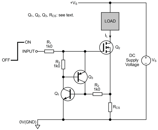

However, by adding just two inexpensive components, you can adapt the circuit to provide effective current limiting with none of the power dissipation problems. The resulting Design Idea in Figure 2 functions as a latching circuit breaker.
Load switch with self-resetting circuit breaker
Figure 2. Load switch with circuit breaker protection.
To understand how the circuit works, assume that INPUT is high, Q2 is on, and normal current is flowing in the load. Under these conditions, the voltage across RCS is less than VBE(ON), and so Q1 has insufficient bias to conduct fully. Any slight leakage current in Q1's collector is diverted away from Q3's base via R3 which clamps the PNP's base-emitter junction voltage to a few millivolts or less, thereby holding Q3 off. Provided the load current remains within normal limits, both Q1 and Q3 remain off and have no effect on Q2.
As with the simple current-limiter of Figure 1, a load fault resulting in excessive load current will increase the voltage across RCS above the 650 mV needed to turn on Q1. However, additional transistor Q3 acts with Q1 to form an SCR-like structure; when Q1 turns on, it floods Q3's base with current, which itself turns on hard, sourcing more current into Q1's base. This positive feedback around Q1 and Q3 ensures that they both rapidly turn on hard.
R2 is necessary to ensure that most of Q3's collector current flows into Q1's base, effectively isolating Q3's collector from the relatively low resistance of RCS. With Q1 and Q3 both switched on hard, Q2's gate voltage relative to 0 V is clamped to a low value, typically around 800 mV or so. Since most N-channel MOSFET's need a gate-source voltage of at least 2 V to switch on, Q2 now turns off rapidly and the load current and the voltage across RCS fall to zero. However, since Q1 and Q3 are both latched on, the MOSFET remains off, thereby protecting it from overheating.
The circuit breaker can be reset simply by taking the INPUT signal to 0 V, which deprives Q1 and Q3 of current such that they both turn off. Taking the INPUT high again will switch on Q2, and normal operation will resume only if the load fault has been removed. If the load fault persists, the circuit breaker will immediately 'trip' and switch off the MOSFET.
The resistor values shown in the figure should be adequate for most applications. Make sure that the value of R1 is not too small, otherwise excessive current could flow into the INPUT terminal whenever Q1 and Q3 are latched on. The MOSFET should be selected mainly to handle the maximum load current and supply voltage requirements. Most general-purpose transistors with good current gain are suitable for Q1 and Q3.
