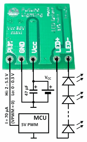

PWM dimming
Average LED current can be controlled by the PWM signal. This dimming control is popular and easily implemented with an MCU or other technique such as a 555 timer. The PWM signal is connected to the PWM input of the module (Fig. 3) and with active LOW < 0.3 V, and active HIGH > 2 V (CMOS). The TS19376 accepts relatively high PWM frequencies and therefore can realize fast PWM dimming with more than 8 bit resolution.
A Low-cost 0.5 A 33 V LED driver module with 90+% efficiency
Figure 3. LED Driver module connection diagram.
The PWM input has pull-up resistor, therefore once the PWM input of the module is unconnected, ILED reaches the maximum current value. Recommended PWM frequency is above 100 Hz to avoid visible flickering.

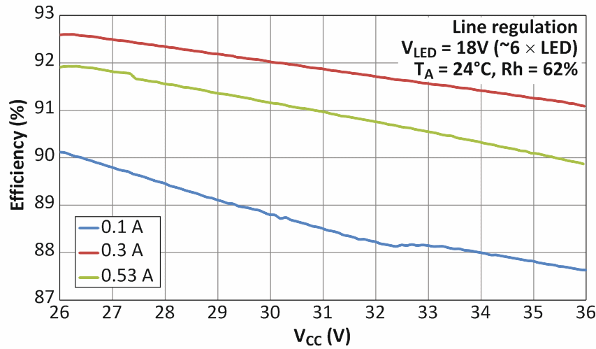

The described LED driver has numerous applications from driving middle and high power LED arrays, to battery charging and much more where a constant current source is required. The number of LEDs in a serial string is determined from the minimum allowed input voltage (VCC). As can be seen from the charts in Fig. 4, the closer VLED is to VCC the higher the efficiency. For example for VCC = 12 V, 3×LED in series is a good choice (VLEDF ~ 3 V). All measurements in Fig. 4 were acquired on automated measurement setup at room temperature.
Figure 4. Efficiency vs. VCC.
