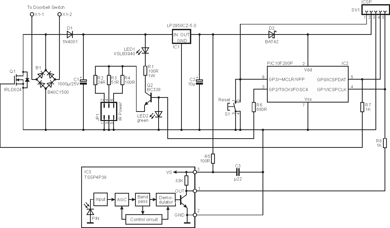

Using the TSSP4P38 proximity sensor, I built a small device that activates the electric circuit to ring the doorbell when it senses anything staying in front of the door. Typical alarm systems would use a passive infrared (PIR) sensor, but for Leonie these devices have two disadvantages. For one, in order to avoid false alarms, they are designed to ignore pets. Secondly, they only respond to moving objects, and can’t sense a cat sitting still in front of the door. At best, they would ring the doorbell when the cat starts moving again; that is, when she leaves. With the TSSP4P38, my sensing device detects when Leonie arrives, waits a few seconds to see if she stays, and if she does it rings the bell.
«Magic» Cat Doorbell
Prototype of the “Nuntiator” that announces Leonie’s presence.
For this purpose, I placed the sensor on one side of the door frame and connected it to a microcontroller that has additional connections to a driver circuit for a VSLB3940 infrared emitter, and to an IRLD024 MOSFET that controls the doorbell. All of these are Vishay parts, with the emitter and sensor mounted in a TSSP-HA for optical isolation. The microcontroller is a Microchip PIC10F200, the very smallest member of its family. This chip can memorize 256 program instructions, which is sufficient to handle the sensor and to implement an alternate mode of operation in which the program sends the values of some significant variables to the serial interface of a PC for debugging, instead of ringing the bell.
TSSP4P38
A significant portion of the component count goes into the driver circuit for the emitter LED, which is a constant current source. Jumpers determine the current and thus match the sensing range to the environment. If the current is too small, the cat may not be detected when she is sitting at the opposite side of the door; if it is too high, the sensor might “see“ too much of the other side of the door frame and ring the bell when it shouldn’t.
Proximity Sensor (Rings doorbell for the cat.) Andreas Freiherr.
Power consumption is so small that the supply current may be harvested from the doorbell transformer by using the voltage across the open switch, leading to a simple two-wire connection. To ring the doorbell, the device shorts its supply, and an electrolytic capacitor keeps the controller alive until it turns the bell off again.
The software in the microcontroller uses a timed loop to generate the 38 kHz carrier for feeding the VSLB3940 emitter and measure the duration of the TSSP4P38’s output pulse. The program then computes a moving average of the most recent readings and uses it to fine-tune a threshold that classifies the next reading as either “close” or “far.” “Close” readings are counted, and after a predefined number of consecutive “close” readings, the MOSFET is switched on to ring the bell.
