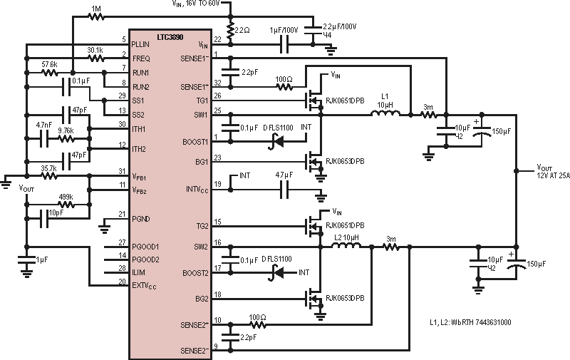

Figure 1. High Efficiency Converter Produces 25 A at 12 VOUT from Inputs Up to 60 V.
High Efficiency 2-Phase Converter Produces 12 V at 25 A
Figure 1 shows the LTC3890 in a 2-phase single output step-down converter configuration that delivers 25 A at 12 V, which can be scaled up to 75 A by adding more LTC3890 ICs to increase the number of power phases. For lower output current, the single-phase LTC3891 can be used. Implementing a 2-phase converter simply requires tying together the independent channel pins of the LTC3890, namely, FB1 and FB2, TRACK/SS1 and TRACK/SS2, RUN1 and RUN2, ITH1 and ITH2. Although the ITH pins are connected together, each is terminated to a separate 47 pF capacitor to compensate for possible noise from interconnecting traces. A relatively low switching frequency, around 150 kHz, and a relatively high phase inductance of 10 μH are used to reduce switching losses at high input voltages. The output voltage is fed to the EXTVCC pin to reduce losses associated with biasing the chip and internal gate drivers at high input voltages.

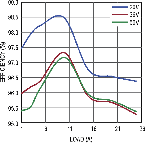

Figure 2. Efficiency at VIN = 20 V, 36 V and 50 V.
Circuit Performance
Step-Down Converter Delivers 25A at 12VOUT from Inputs Up to 60V

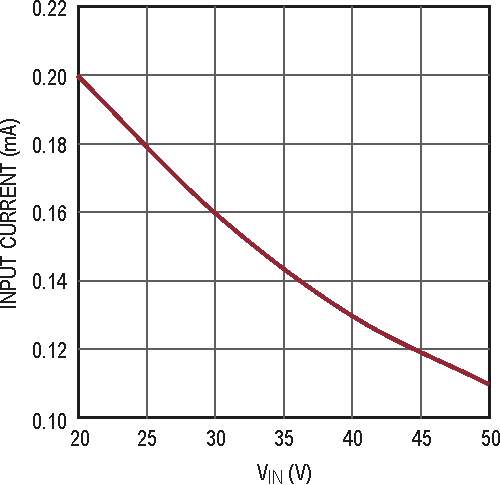

Figure 3. Average Input Current vs Input Voltage at No Load.
VOUT is 12 V.
Efficiency is shown in Figure 2, measured without cooling air flow. Efficiency peaks close to 98% in the middle of the load range and declines to 96% at the 25 A maximum load. Figure 3 shows the average input current vs input voltage at no load in Burst Mode® operation. The value of this current is below 0.5 mA. Figure 4 shows a thermal map of the board with no air flow present at VIN = 20 V and VOUT = 12 V at 25 A (300 W).
