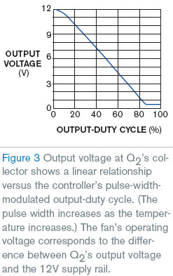

Figure 3 shows a graph of the dc voltage at Q2's collector versus IC1's PWM drive-output waveform's duty cycle. The voltage applied to the fan corresponds to the difference between Q2's collector voltage and the 12 V supply voltage. Even though a steady voltage appears across the fan, current pulses that the fan motor's commutation produces still develop a voltage across current-sense resistor RSENSE that connect to Q2's emitter, and all of IC1's protective and advisory features remain available.
