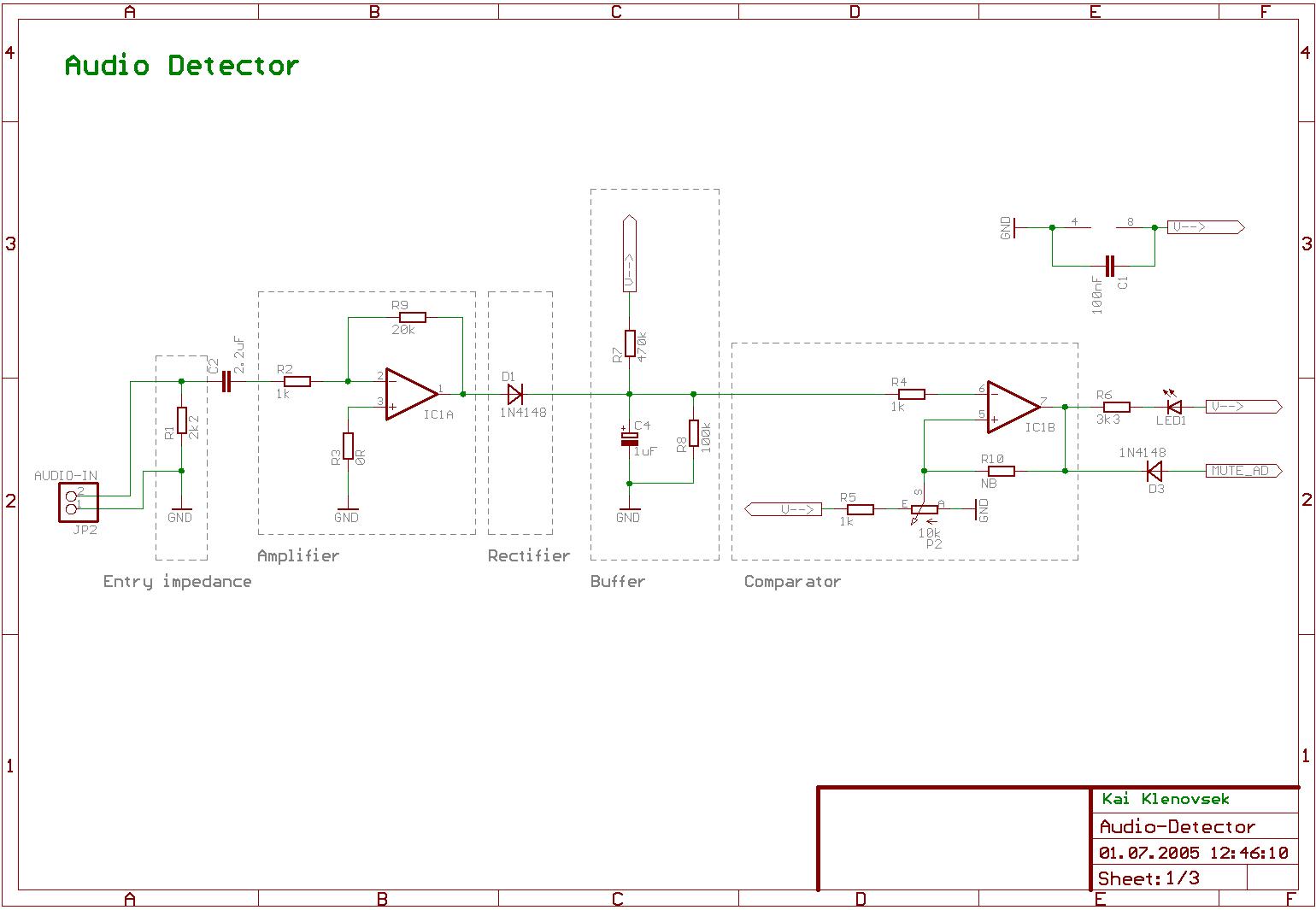

This circuit is for detecting any audio signal with justable noise offset. It could be used to generate a radio mute signal eg. from a PDA.
The circuit is consisting of:
- Input impedance
- Signal amplifier
- Rectifier
- Justable comparator (Noise offset).
