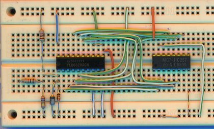

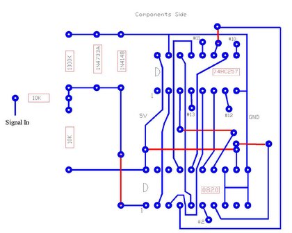

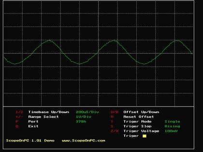

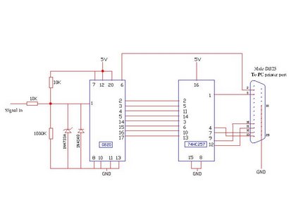

ScopeOnPC is a free software that uses the PC parallel port and an ADC (Analog To Digital converter) circuit to turn your PC into a full featured ocliloscope.
Key Features
- Sampling: 100K Samples per second (DOS version) -100KHz
- Sampling: 40K Samples per second (Windows version) - 40KHz
- -5 V To +5V Input Range
- -50V To +50V Olerload Protection
- 8 Bit Resolution
- Scope Timebases:100uS/Div To 100mS/Div
- Scope Volts/Div: 100mV/Div To 5V/Div
- Works with ANY parallel port
The ScopeOnPC for DOS can run under DOS , or in Windows 95/98/2000/XP/Vista window.
The program is very small and very fast as most of it was written in Assembler
