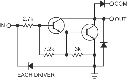

Figure 2. The internal configuration of the high-voltage Darlington-array ULN2023A
driver exactly matches the requirements of the circuit in Figure 1 by
providing rectifier diodes at the collector outputs.

The internal schematic of the high-voltage Darlington-array ULN2023A driver in Figure 2 exactly matches the requirements for the circuit in Figure 1 by providing rectifier diodes at the collector outputs. The voltage-breakdown specification of 95 V meets the maximum requirement of twice VCC plus transients when operating at an input of 30 V. The device exhibits a low collector-to-emitter saturation voltage at the desired current level of approximately 100 mA and low switching times when switching at rates as high as tens of kilohertz.

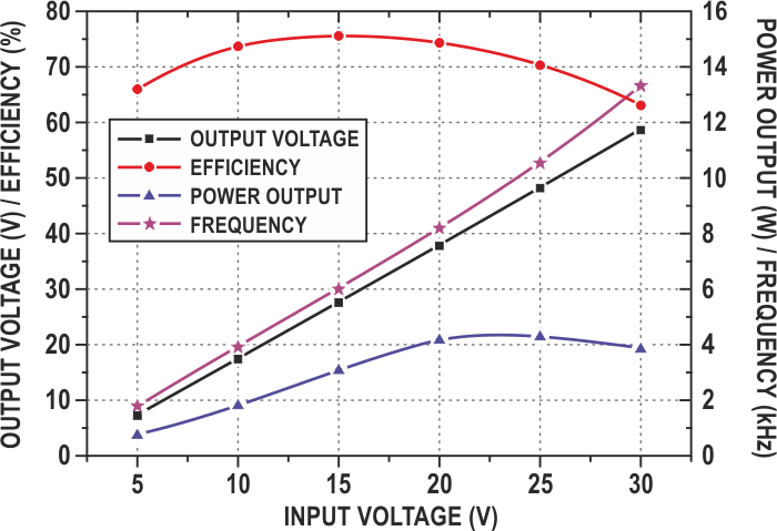

Figure 4. Experimental results show the circuit in Figure 3 operating as a
low-power, moderately efficient, wide-range voltage doubler.
Figure 3 shows the final circuit configuration. Three drivers operate in parallel, sharing the drive current, minimizing the collector-to-emitter voltage, and maximizing the permitted power dissipation. Table 1 shows the experimental results with the voltage-doubler circuit operating over the input voltage of 5 to 30 V. In that range, the input current is less than 300 mA to remain within the current values of the transformer at lower input voltages and within the power-dissipation limit of the ULN2023A at higher input voltages. Figure 4 shows the plot of the experimental results, clearly indicating the operation of a low-power, moderately efficient, wide-range voltage doubler.
