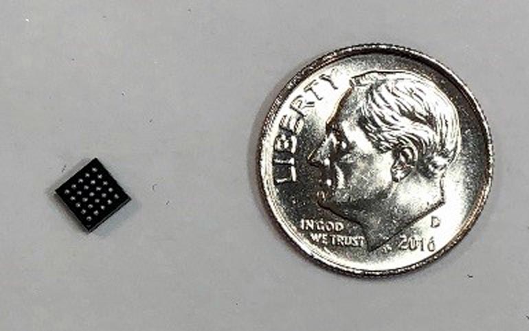

The LTM8074 is a complete, ultralow EMI, high voltage input and output, DC/DC step-down switching power supply. The controller, power switches, inductor and all support components are included in a low profile 4 mm × 4 mm × 1.92 mm surface mount RoHS compliant BGA package (Figure 1), enabling utilization of unused space on the bottom of PC boards for high power density point-of-load regulation.

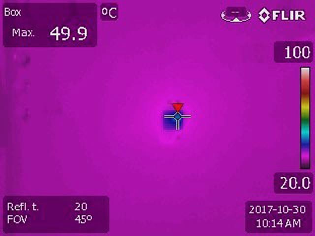

The LTM8074 operates over an input voltage range of 3.4 V to 40 V and output voltages from 0.78 V to 15 V. The output voltage is precisely regulated while delivering output current to 1.2 A. High efficiency and a thermally enhanced packaging enable excellent thermal performance and high power density. Figure 2 shows the LTM8074 under loaded conditions with minimal rise in case temperature and low thermal resistance.

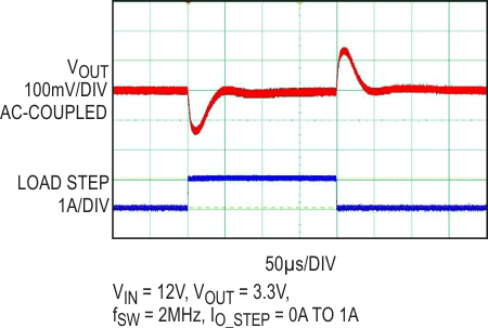

The internal controller’s peak current mode control architecture enables fast transient response and good loop stability. Figure 3 shows fast transient response and low peak-to-peak voltage deviation in the output voltage.

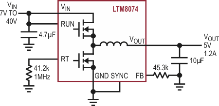

Fits into Tight Spots
Minimal Components Needed for 7 V to 40 V Input, 5 VOUT 1.2 A Design.
Figure 4. Minimal Components Needed for 7 V to 40 V Input,

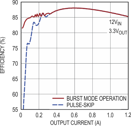

All support components are integrated into the LTM8074’s compact form factor, simplifying layout design and reducing solution size. Only input and output capacitors, frequency and voltage setting resistors are necessary to complete the design. A typical application circuit and its efficiency are shown in Figures 4 and 5, respectively.
LTM8074 Typical Efficiency.
Figure 5. LTM8074 Typical Efficiency.
Although the LTM8074’s μModule design results in a nearly self-contained, drop-in regulator, a number of design parameters are easily adjustable to meet the needs of specific applications. The output voltage and operating frequency are resistor programmable and the operating frequency can be set to synchronize to an external clock. The LTM8074 also features programmable soft-start, output voltage tracking, power good indicator and enable control, as well as a variety of conduction mode options, including pulse-skipping mode, Burst Mode® operation and spread spectrum modulation, further optimizing light load efficiency and EMI performance.

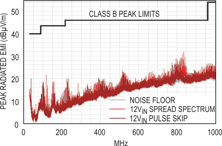

Ultralow Noise: CISPR 22 Class B
The LTM8074 Uses Silent Switcher Architecture for a Complete Low Noise Solution in a Tiny Package.
Figure 6. EMI Performance vs CISPR 22 Class B for 12 VIN to 3.3 VOUT at
1.2 A (3 meter, Peak, Vertical Antenna, No EMI Filter).
Switching regulators naturally produce radiated EMI, as their operation requires high dI/dt events at relatively high frequency. Instead of relying on cumbersome EMI mitigation techniques – such as lowering the switching frequency, adding filter circuitry, or installing shielding – the LTM8074’s low EMI performance is a result of a built-in, proprietary Silent Switcher architecture. No external circuitry or special layout techniques are necessary to meet radiated EMI standards, such as CISPR 22 Class B, as shown in Figures 6 and 7.
